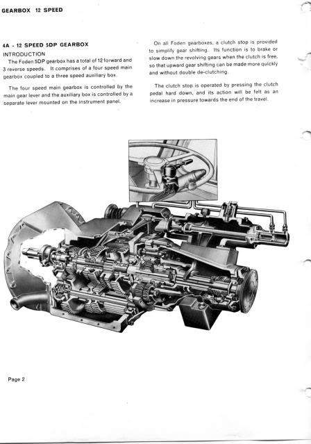

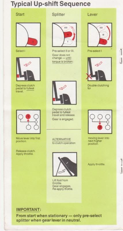

An exploded view of the Foden 12 speed g/box, and the diagram showing the recommended gearchange pattern. Foden’s used to have a clutch brake as well, their instruction was that when changing up on the main box you pushed the clutch pedal halfway down, moved gearlever to neutral then pressed the pedal fully to the floor and engaged next gear. For changing down, double declutch. In practice however, unless the clutch and it’s brake were adjusted “spot on” it was easier to double declutch when changing up as well.
The auxillary box was changed by either flicking the throttle or dipping the clutch, the air change was instant although as anyone who has used one might testify you could end up with a box full of neutrals!! :neutral_face:
Basically, if you couldn’t get up a hill with a Foden then you needed something on tracks. :wink:
