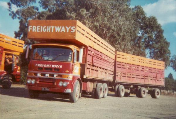

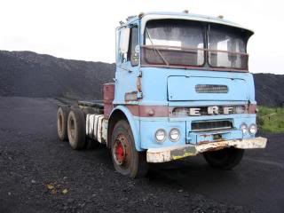

ERF with 3MV cab.
This LHD unit appears to have a 2MV cab. Robert

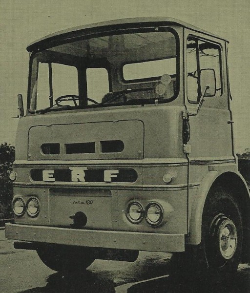

This appears to be a 3MV cab…
That should at least get the ball rolling! Robert :slight_smile:

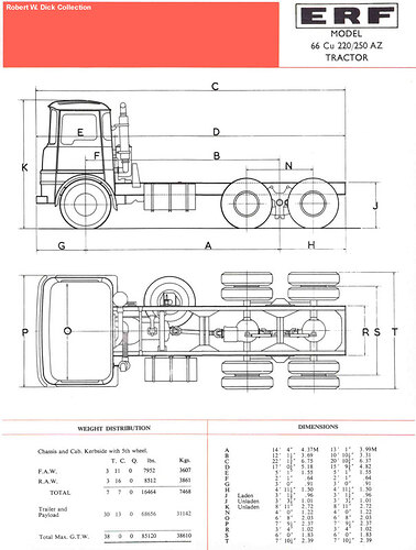

If you look in Dai Davies’s book, ERF the Inside Story, there are dozens of MV-cabbed export ERFs literally all over the world. Robert :wink:

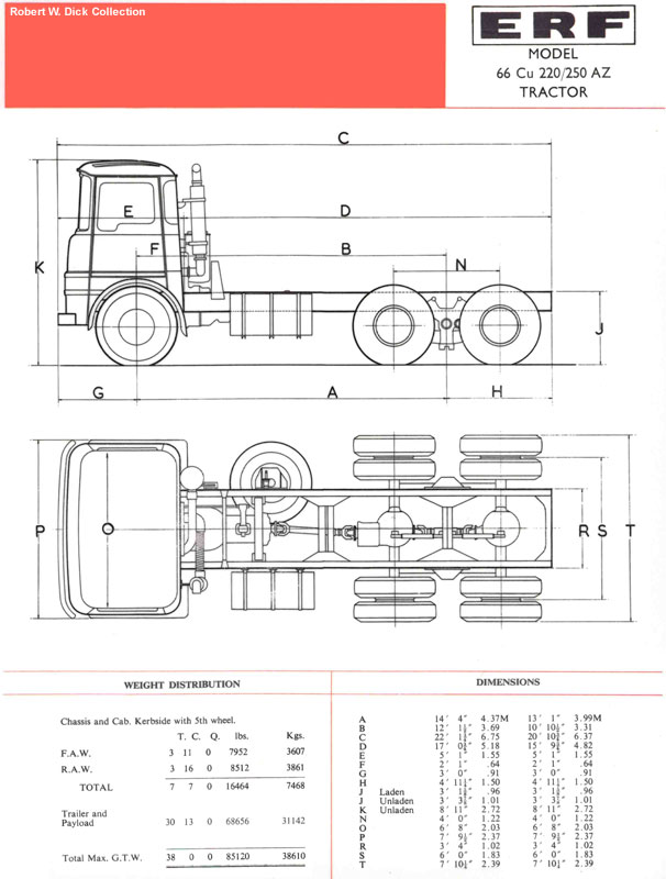

These two pics were kindly posted by En-Tour-Age on the 4MW thread. Robert
Picture of the opened folder from 1965

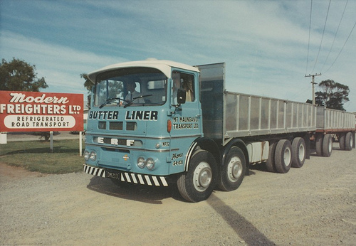

The first MV cabbed ERF is recorded as chassis 13263, a 2MV cabbed model 6.4 CU220 -10’1" wheelbase 4x2 tractor unit despatched ex Sun Works on the 28th Feb 1966 and destined for ERF South Africa.
The last MV cabbed ERF is recorded as chassis 23059, a 5MV cabbed model 6.8 CU310 of 18’ wheelbase 8x4 despatched ex Sun Works on the 4th Jan 1972 to I.S & P (New Zealand Dealer) for owner L.E. Elms & Sons and was registered GC3762.

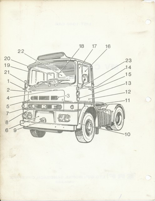

Master parts list header for the MV cab (Later designated 2MV when the 3, 4 and 5 came along)

Not many service bulletins seem to have been issued for the MV cab, but here is one of the more interesting ones…
I have left out the part number lists for these manuals as there are about 25 of them.
If anybody wants anything specific, I will try to oblige.

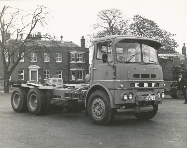

Thanks for posting all that, ‘ERF’. I found this picture by Dai Davies in his ERF history: would it be the bonneted South African MV you referred to? Robert :slight_smile:
robert1952:
It would indeed Robert!.
Well done!.
