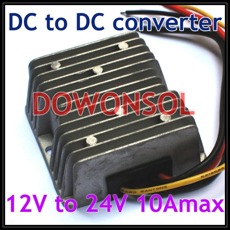

Yes, you just need a step-up converter, not sure what rating it will need to be to run a night-heater but this is the sort of thing, just Google for “step-up converter” or “voltage doubler”.
The ones in galaxys are 12v but they are hydronic, ie heat up the coolant circuit, you need an airtronic.

thanks lad,s il do what you say Harry ive got a better idea now cheers Mark
