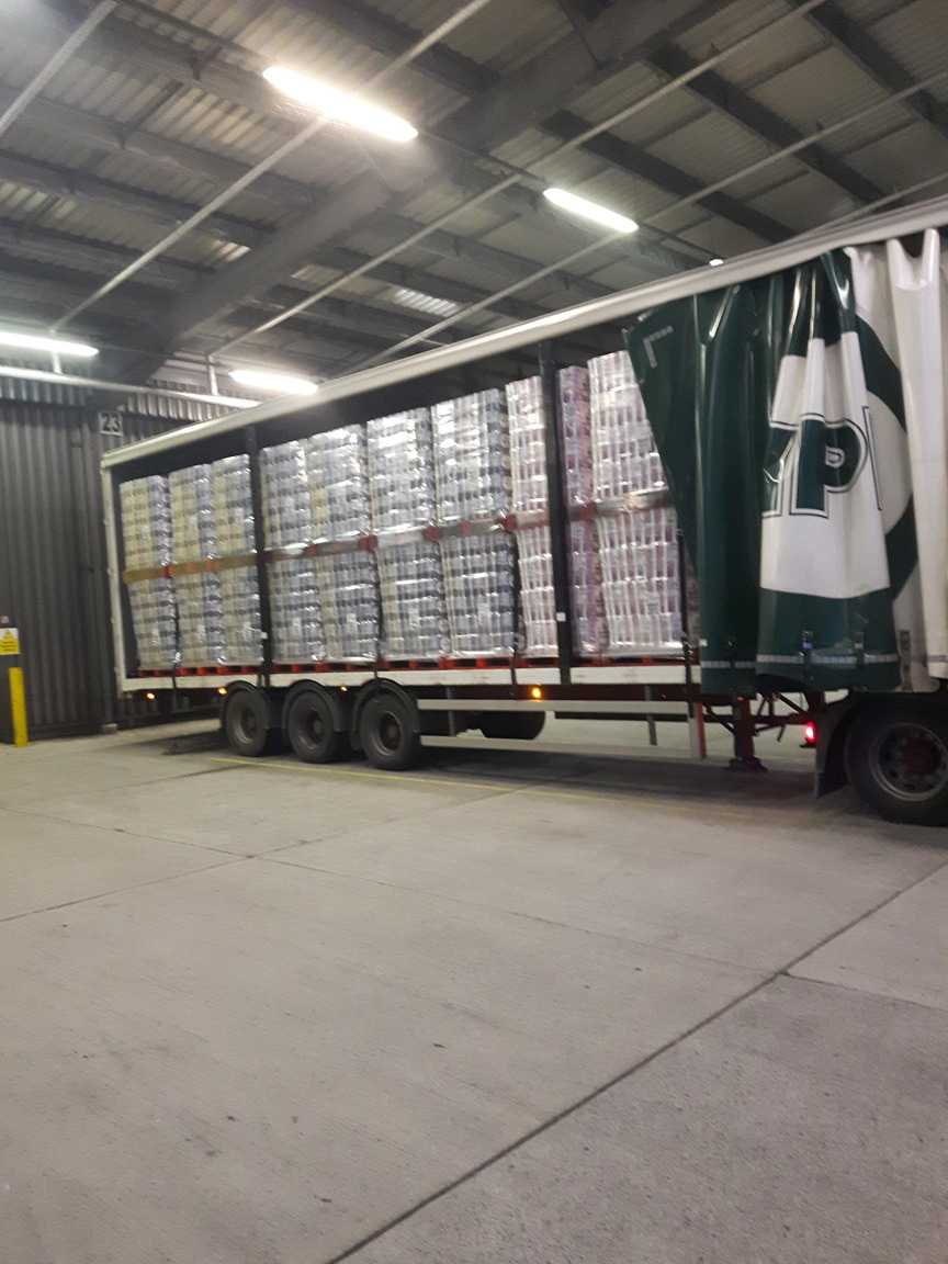

All I know is there was 3 bits of paper stapled together. The front one was pg something or other? Which said what’s been checked.
The next was a report which was preventing the driver from going back out on the road requiring immediate attention, and the third was saying that issue had been rectified and was good to go.
He said something about that middle one in the comments section said something along the lines of “load not secured correctly, high chance of moving and posing a danger to the public”. That’s not quoted but that’s along the lines of what he told me.

I dont understand why when anyone gets told xl rated they think they are driving a bulker with solid sides and dont have to strap anything.
Just because your curtains say code xl doesnt mean your trailer is, plus there and loads of things that make a load “suitable” for xl.

I personally wouldn’t consider that a full load of kitchen towel needed strapping apart from cross-strapping the rearmost two pallets. I cannot imagine a scenario where it would come off of the trailer unless the vehicle jack-knifed and overturned and in that event it would come off of the trailer even if side straps were used. To say that kitchen towel can be strapped down using spansets is just ridiculous.
Everyone is entitled to do as they please, i was taught, albeit in austria, that ALL loads need to be secured. Of course there are many ways to secure things. To me it just seems weird/crazy that people are driving around with loads full of palletts un strapped.
Your right harry, a pallett on kitchen rolls shouldnt move, but what shouldnt happen and what dvsa deem acceptable is another.
I use to drive 27t of canned drinks around europe, positive fit with a xl taut with 48 interlocking aluminum lats and two horizontal locking lats at the back. This conformed.

I have no idea why I’m sticking up for The Humourless Men With Clipboards here, but they have a rule/procedure that says approximately “If you can fix the issue right here, right now, we will in-impound the lorry and you can be on your way”.
The ratchets were simply the way of ticking that box, because of how the driver had set up the internals in the first place. Their load bearing capacity etc had nothing to do with it.

I’ve pulled loads for KC (Barrow to Flint) on a number of occasions. Every other double stacked row of pallets cross strapped using internals, and the load has always arrived in perfect condition, despite me using my finest rally driver agency driver attempts at ruining it.
Just a thought here when loading pallets of empty glass bottles we are told you have to strap them the same waybut every 2nd pallet couldnt put a ratchet strap over them and our trailers are full xl rated curtains, headboard doors and whatever else we even got the en certificate in a pouch on the tr just to prove in case of stop

Yep, done Quinn glass at Elton plenty times. (Chester services next door, highly recommended :wink: ).
Same score, every other double stacked row, and airbags at the back doors. These DVSA knobs need to get a grip :unamused:
