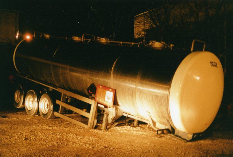

It didn’t mention anything about dropping the trailer on solid ground…
Tankerman:
Was that pic taken at the truckstop colsterworth
That picture was taken on the spare land at Gilbraith’s Accrington depot. The tank was loaded with caustic soda.
The fitters pumped it out into another tank, jacked up the empty one moved it on to hard standing and blew the load back onto the tank again. Management never found out, that’s what you get with a good team who looked after a careless driver.
As you can see it was in the evening and drinks all round were called for.
Seen the same thing at colstrrworth one night cpl of guys doing a trailer swap in the back park i didnt have the heat to take a pic thow
