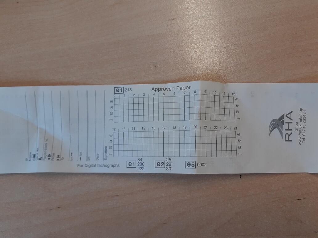

Digi tachos seem to be retrograde v paper charts regards manual entries ?.The chart was effectively also a miniature graph type log book as and when required.

This will hopefully save you some pain Switch,
The reverse side of a print out from a digital tacho Carryfast
