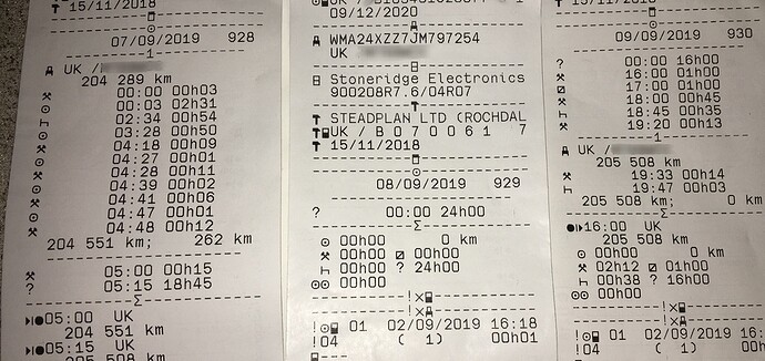

I really can’t see what I’ve done wrong, here’s printouts for the last part of my Saturday shift the Sunday I was off and then the Monday I started back, all my weekend rest is indicated by the “?” Symbol, please explain my error and why I’ve caused the drive to be on there.
The 15 mins driving isn’t showing on you print out, its showing 00:00 driving, so is unlikely to be on your card, the display on some trucks don’t always tally up with the tacho.
