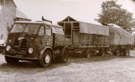

Prime Mover. Dolly and Trailer. 2 pivot points.
