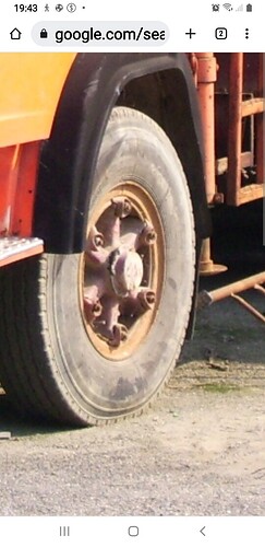

On a side note…has anybody else had any experience of this type of wheel rim set up?
I had a Fiat with them,.they were a pain in the arse for keeping tight, I have memories of a night out at ‘Ackers and Jarret’’ the Walsall Fiat and Iveco agent after it coming loose (are they still there?) the garage foreman and me got ■■■■■■ out on the town that night

On a side note…has anybody else had any experience of this type of wheel rim set up?0
I had a Fiat with them,.they were a pain in the arse for keeping tight, I have memories of a night out at ‘Ackers and Jarret’’ the Walsall Fiat and Iveco agent after it coming loose (are they still there?) the garage foreman and me got ■■■■■■ out on the town that night,…and I spent all next day there!! (Last bit for the benefit of Adam on here.
Yes trilex wheels a pain to get straight if you didn’t tighten them up in the right order but a lot lighter to change than a conventional rim

That looks like a secondary rim.I remember when I was on aYTS scheme for HGV mechanics,they told me that rim can blow loose if its not removed corre tly and if hits you,youre ■■■■■■

robroy:
It’s not a Trilex, it’s a simpler spider rim.
Sploom:
That looks like a secondary rim.I remember when I was on aYTS scheme for HGV mechanics,they told me that rim can blow loose if its not removed corre tly and if hits you,youre [zb]
The wheel is centred/aligned with wedges under each nut, these are what can go off like a bullet.
The correct procedure is to undo the nut until it is flush with the end of the stud, then hit the wedge with a hammer to loosen it.
