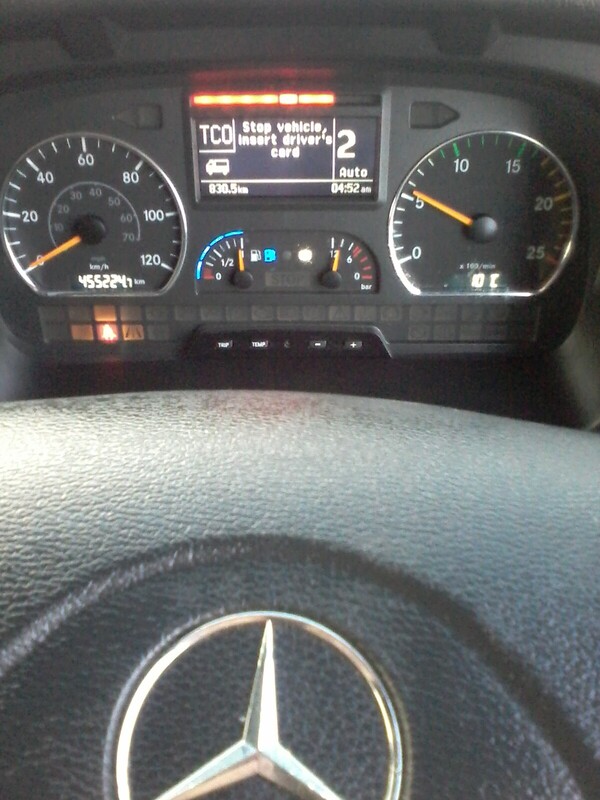

trubster:
Dozy, you are living up to your name.
In an Axor, the Tachograph flashed with “DRIVING WITHOUT CARD”. Also the dashboard lights up Red and says something like “STOP VEHICLE - INSERT DRIVER CARD”
How on earth you missed that, I don’t know, do you pay attention to anything else on the dash? Speed? Oil Level? Fuel Level? Warning Lights/Messages? :unamused: :unamused: :unamused: :unamused: :unamused: :unamused:

My 11plate axor did this:
mrginge:
I put in in slot 2 once drove for 45mins to first destination and the thing kept flashing which i just OK’d and cracked on. Took a while to figure out it was in slot 2 :blush:
Bingo !
Me too. :smiley:

I’ve been driving axors from 09 plates through to 14 plates and they have all flashed up red if you move em without a card in saying driving without card. You can’t really miss it.
deftone:
Apparently you can if you are “dozy”
Shame he ha disappeared again. He seems to post something that makes him look a ■■■■ and doesn’t come back for a week and then rinses ad repeats.
My Premium comes up with a massive T on the dash with “Card not inserted or not recognized”.

trubster:
When I was first given a AXOR it said SERVise immediately so I defected it ,took it too vmu and fitter just said ignore it they all say that ,same as message bulb out ,Ve never found one out yet ,again told just ignore it ,so I do ignore messages .
But if it said taco not inserted I’d done something ,maybe it did and I just ignored it as I just assumed it was like the others ,not true .
I’m baffled too be honest ,a fair chunk of the 40 miles was through road works on m1 so there’s not much room so I would of been concentrating and could of missed it ,but still doesn’t explain the other part of the journey and then not realising I’d of ejected the card .maybe it’s im swapping from scanias - axor on a daily basis so missing things .
But I assume what there sayings right and there are warnings so I better get more sleep and concentrate a bit more :confused:
