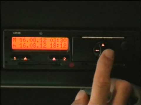

Here’s a couple of videos showing manual entries on Siemens type 2 digital tachographs.
When you’re doing manual entries it pays to take your time and watch what’s happening on the display.
If the videos help you please give them a thumbs up on their YouTube channels to support the video makers :wink:
