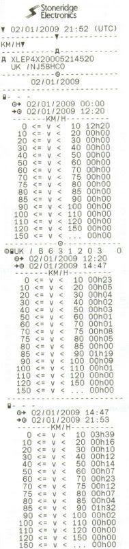

I’m sure you can get a speed trace from the head unit on a digi tacho. It’s in the user manual about the various printouts that you can get. But it might be for only the last 24hrs.

As stated by other members, the actual tacho holds speed information for 24 hours.
If you suspect there may be a query or you noticed a camera flash you, you can request that your transport manager download the data within 24 HOURS or that data will be lost.
Where I work if a driver thinks there may be a speed dispute, the vehicle is taken out of service until the tacho head is downloaded with a “dongle”. Every TM or fleet desk should have one of these and be competent in using it. :wink:
something similiar to what you want
i got this by accident stabbing away in a Scania with Stoneridge

Hi I would say no you can not be prosecuted for speeding as the print out is not an accurate speed, if you look at the example of a the print out in the post it give you a range of 10 kpm and the length of time the speed was done for as you can see it does not show the true speed,
the print out is for the truck and not the driver.
your digital tacho card does not record speed only the head unit does and only for 24 hours

Digital tachographs store the speed in the Vehicle Unit (VU) for the last 24 hours of vehicle movement after that time the record is overwritten. Speed data is stored by the second and recorded in whole kilometers per hour. Speed data is not stored on driver cards, apart from records of ‘overspeeds.’
