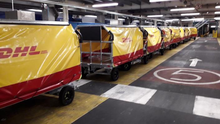

Not strictly truck related but … flew back into Manchester this afternoon and as I was walking to passport control looking out towards the runway I noticed some baggage carts with red and yellow tarpaulins on them and emblazoned with DHL, nothing too strange there , but then i noticed the carts wheels had yellow wheel nut markers on them :open_mouth: where the hell is it going to end ?
It tickled me and at the same time I was a bit gobsmacked that elf n safety has gotten to this level :unamused:

I often find the people who say this lacking in their ability to think for themselves and imagine what the reason could be. Maybe it is as a result of one or more incidents of loose ones coming off and the contents of said carts coming off and possibly hitting someone?
Yellow wheel nut markers on trucks were brought out for similar reasons, loose nuts which spanner drivers didn’t check for resulting in wheels coming off so an idiot proof solution that even those who can’t think for themselves could understand was devised.
I imagine a cart wheel being sucked into a jet engine may cost a bit more than some check markers

While i was doing my trade training in the RAF many moons ago, the sootys had a cut away turbine engine that something as innocuous as a paper clip or washer had been sucked through. It chipped one of the initial blades which in turn totally mutilated the subsequent blades and screwed the engine. This is why airports get a tad twitchy about FOD and hence wheel nut covers on airside trolleys. Sorry for sounding a bit noddy.

Most likely based on a recent incident, I suspect a wheel off one of these would cause massive disruption to timetables, extra work for ground crew, Fed-up passengers and a big bill for DHL
