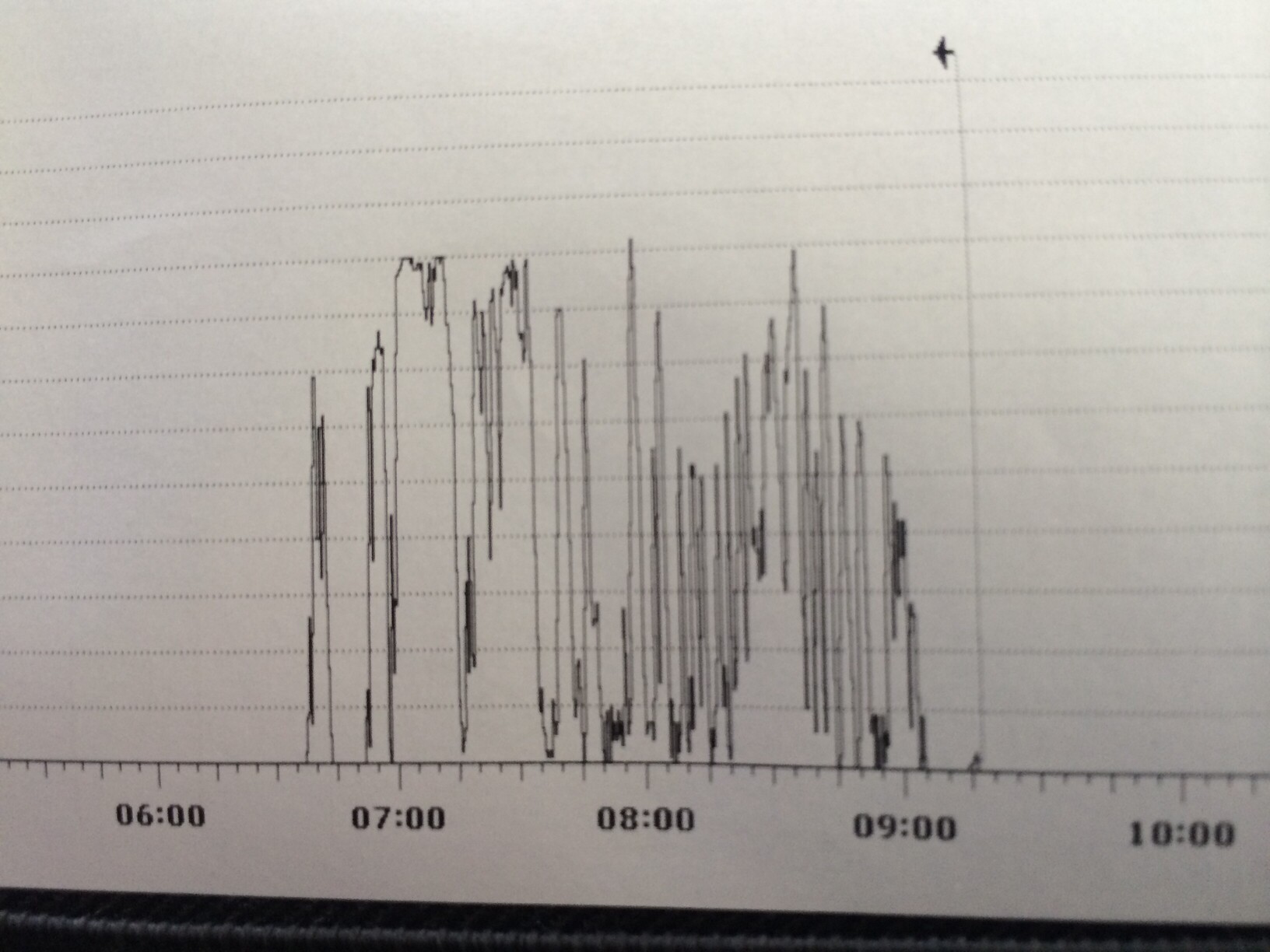

Re, driving time, the digi tacho driver part does not record all driving as driving, especially in stop start traffic, I did a print out of some driving which included a bit of stop start traffic on the motorway and the driver part didn’t record all the driving activity.
The vehicle speed trace in my opinion recorded approx. 2hrs 25mins driving, but the driver display was showing 2hrs 10mins driving, seems to me on a daily basis the tacho is just deducting a certain percentage of driving to keep every one happy!

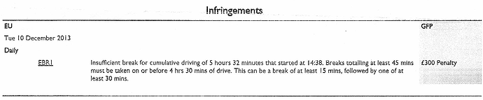

when i had in infringement for 5hr 32m driving without a break, i thought there would have been more time allocated to other work whilst in a traffic queue. Seemed only need to move for a few seconds, and that was rounded up to a minute. I think this was my worst day in terms of infringements, could have been worse, but i got my 15m break in for 6 hour rule, just, Only reason there was additional driving after 5h 32m when i took break is because I got to delivery point and said I can’t move until after 45 minutes on break, they said move it now, we need it on a bay to unload. One manager suggested pulling the card
