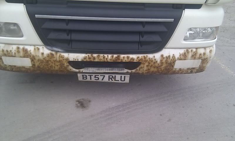

Here is a prime example! Its coming you cant fight it, its the DAF cancer
