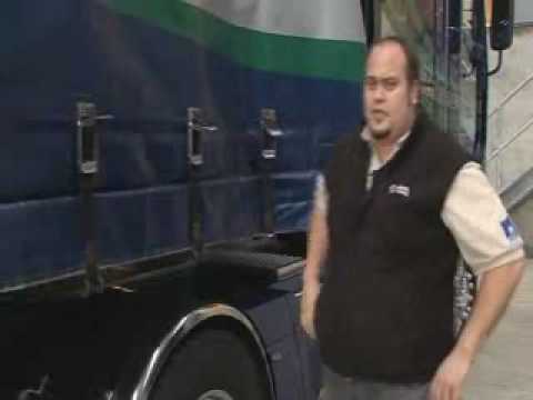

There are minor variations to how the buckles open, and how the tensioners are released but this should give you an idea.
One thing to remember is to cover the front tensioner with the curtain to help prevent the suzies getting snagged on the tensioners.
