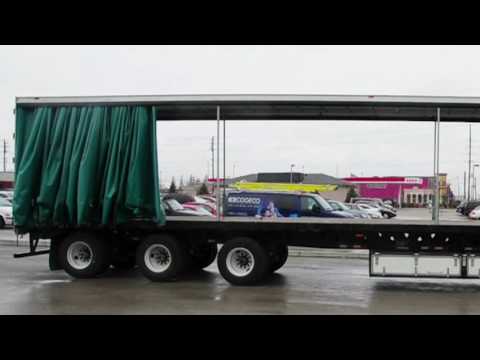

A couple of videos which may help.
Notice the movement of the uprights in the second video and how it works, these can vary a bit but I’d say the ones in the video are typical.

Pease bear in mind that a curtain needs to be tensioned BOTH horizontally AND vertically…
Below is my attempt to give you the basics…To open a curtain, first you need to get rid of the vertical tension.
To do this, you open the “buckles” by pulling downwards on the strap as in the pic…
Then, lift up the buckle and unhook the strap from underneath the deck…
(Have a look underneath to see how to put it back later)
Do this, from the front, as many times as you need to gain the opening that you need…
Then de-tension the curtain horizontally by pulling the (smaller) lever at the bottom of the tensioner towards you…
Then unhook the front pole by lifting it upwards…
To close a curtain, pull the curtain pole back to the the tensioner and engage the pole in the slot…
You might need to turn the tensioner to engage the pole in the slot…
Then push the small lever all the way away from you…
Then use the larger of the two levers repetitively to tension the curtain horizontally… it’s a ratchet
Then re-engage the vertical tensioners and snap the buckles shut…

Just to add to this brilliant post :-
Most curtain siders have side post’s - these will have to be moved to one side when you do a side tip - there are many different types - most come with instructions stuck to them in the form of a lable
the main thing to check is that the post is actually attached to the top of the trailer roof - they are heavy and i have had some where they have been in place but unbolted from the roof lol
watch out as they are under tension as they support the roof - and some types spring out and can break noses and teeth
when replacing watch your fingers as they are normally a lever and have pinch points
finally if there are two or more posts each side never never undo all of them always leave at least one post fixed each side - the roof will dip down and you’ll need a fork truck to lift it back -
