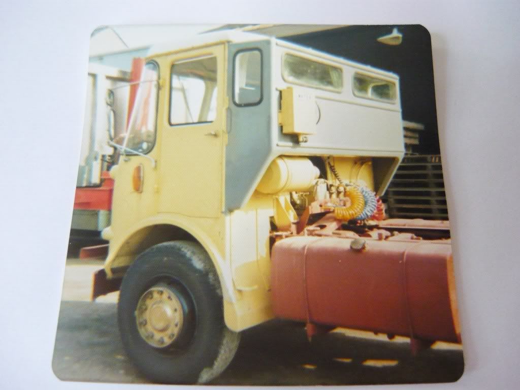

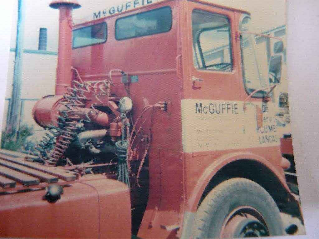

This has got to be the ideal air cleaner set up,this one on the Atki Borderer 8LXB,now why ever would Sed/Atk think it was an improvement to reposition the filter and intake under the cab !! Well at least ERF’s new “B” series,launched at the same time, positioned the Air filter and intake in a sensible place on the rear of the cab.
The 8 cylinder G had the large filter and the 14 ltr yellow peril plus the bigger of the R/R the stack up the back sure did look
good back then trouble was when they got converted to Jennings sleeper cabs you had to take the air cleaner straps mounting bolts off and
wangle the cleaner down and back to get at the air filter, then refit it :smiley: :wink:

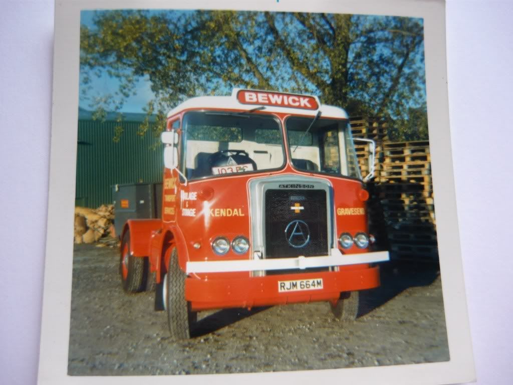

A late '75 shot of a new Borderer just back into the yard from a visit to Jennings !!
oreet dennis i bet they were queingup to drive it eh happy new year bit late been at work ower xmas keepin farmers happy
■■■■■■■ 220 with a road ranger gearbox with the smaller of the air filter housing tucked under the Jennings conversion.
used to bend the grab handle on the side back over to stop the drivers getting their skin scrapped off the knuckles,that aluminium door edge trim was razor sharp as the handle was on the
back on the normal day cab just one of the few little things that made life a little better for the drivers. :slight_smile:
The same spec Dennis ,as you say what a total miss-match of parts. think Waugh’s had 6 Atkis with this spec if i remember this one in the
photo had the large black 4 spoke seddon wheel as did ONL 428M which you ended up with they were the last two to come with no power steering
and the last 220 ■■■■■■■ engines .
