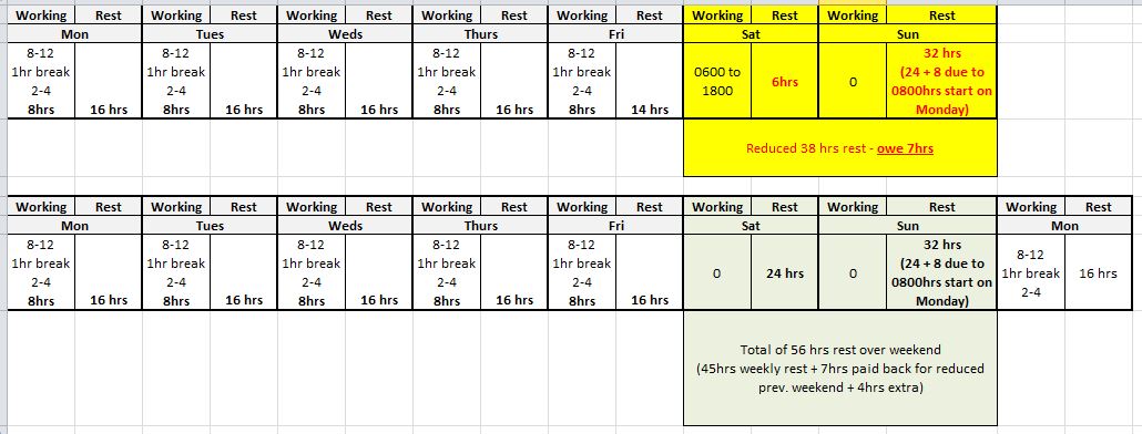

Studying for CPC MOD 2 using drivingtheory4all website.
Applying the workings hours/reduced break to my future short term scenario or working Mon - Fri in my current job and then one day agency on Saturday day (or night??).
I have planned the attached out and think that it is correct where I work 12 hrs on the Saturday and repay the reduced rest over the following weekend but … couple of questions are stopping me thinking it is correct.
  1. Is the Saturday correct at 12hrs work and 6hrs rest??
  2. With the week Monday to Friday, do I have 32hrs rest on the Sunday or is it 24hrs only as new week started?
Many thanks.
Fixed week does not stop rest continuing
I cannot see anything amiss with what you have posted
Very nicely set out WonksterDude. I’ve been playing around with a notebook trying to set mine out in the best way so I can keep tabs on what I’ve done from week to week.
Might plagiarise your set out to give me an overview of the previous week and current week.
I know a tachograph is going to give you a lot of info but still best to do it the way you are comfortable with and I would benefit from a more graphical layout.
Thanks ROG - I may have finally got my head around it then :slight_smile:
Container Boy - go for it, whatever makes it simpler for myself is the way I look at it.
