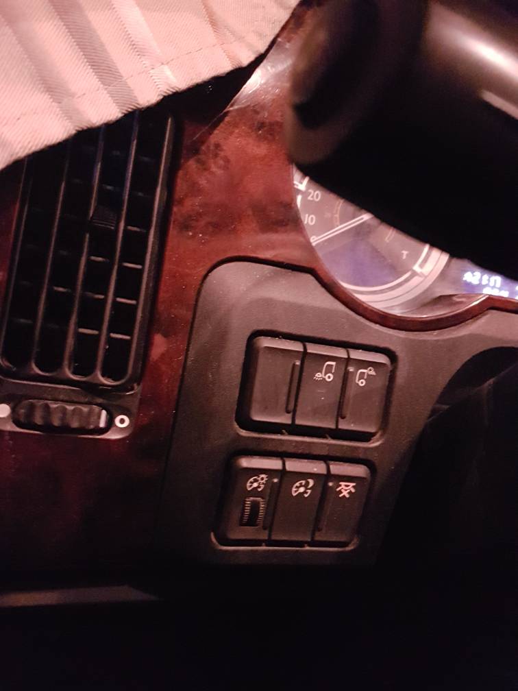

On the row behind and below the steering wheel?
Hidden by indicator arm??
I think you may get better Google results if you search for “Daf XF work lamp” …
Yea, in between the steering column and the driver’s door, below the instrument binnacle.

Have you checked on the top panel above the tachograph unit? Our 65 XF was in the same place as Frangles pic, but ours had extra front and rear light bars and beacons added and all the switches for those were on the top panel. Also, have a look on the lamp itself. Presumably it got removed when it became a drawbar so the replacement is unlikely to be a standard fit. It might have a switch on the lamp itself.
