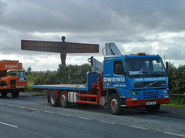

My old FM12 with HIAB at Owens was a stretched ex-unit. 380 engine so plenty of grunt.

Would be interesting to know the unladen weight of the front axle on that conversion…
dave docwra:
Dunno, was over 10 years ago. Load bed was quite a way back though due to the crane.
