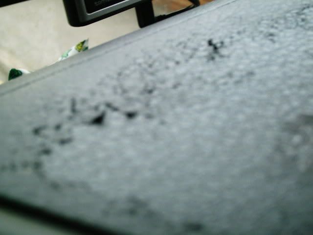

What is the solvent for Cockpit Shine-type dashboard sprays? My new (to me) truck has evidently had gallons of the stuff sprayed on, straight over the dirt, and it has gone all scabby and started peeling off.
Any other advice for removing it appreciated.

EDIT Here’s a pic
I’ve got a fh and previous driver had a smelly on passengers side air vent and the cab was tilted now it looks iike your picture now got a table on with a beer [washed] towel under neath can’t see it now
Harry, 3 in 1 oil rubbed in works better than cockspit shine, also swarfega rubbed in removes most things

I have found out that the solvent for Cockpit Shine is Isopropyl Alcohol, and when I checked the ingredients on the back of my pack of babywipes, alcohol (not Isopropyl, whatever that is- and I’m quite an expert on alcohol!) was the main constituent. Elbow grease, scouring pads and warm soapy water did the rest.
I am going to go to Boots next weekend to see if the chemist will sell me neat Isopropyl Alcohol for the fiddly bits, or where the chemist thinks I would be able to buy some. It’s probably available in Hardware Stores but sold for a different use.

Most chemists will sell you a litre of alcohol, I used to buy ti all the time, for cleaning laser printer toner drums as it leaves no residue/smearing.
