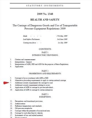

Just for you Lovelyperson, here is what CDG 2009 looks like:
This is a current UK Regulation just made by our parliament. It replaces the 2007 Regs, which replaced the 2004 Regs, usw, usw.
CDG 2009 Reg.7 says that we carry UN Class 1 by our own extra set of rules, and I’ll just add that Reg.7 is a bit stricter than ADR for the carriage of UN Class 1 within the UK.

Hi Lovelyperson, I’m sorry but that’s not correct. Above is a picture of the UK dangerous goods Regulations, and you can see when it came into force, so you don’t have to believe me- just look for yourself.

Hi Lovelyperson, If the info above cost you £150, then you should ask for a refund, because you could have got it for free at a museum.
At a complete guess, I’d say that the info above is about five years old.
The info above does nothing to support your argument above eg. 50mtr rule etc etc.
The info above is from a leaflet (IIRC dated 2004) and is NOT law, so you’re still short of any proper references to support your argument.
I’m sorry, but I’m failing to see what point you’re trying to make…
I’ve already posted a picture of the CURRENT 2009 UK dangerous goods law, so OK, you don’t believe me or you think I photoshopped the whole thing
Hmm… a new approach with a very simple example is needed…
MR Lovelyperson, do you agree that UK tanker markings are quite different to those used on international journeys and by the other ADR member countries A simple “yes” or “no” will do nicely please.
Now we know that they are different, why don’t the police/VOSA fine every UK tanker driver for using the wrong vehicle markings
That is because there is a UK LAW that says we MUST use UK tanker markings.
That law is CDG 2009, which is pictured in my post above. Like I said before: <Schachmatt>
