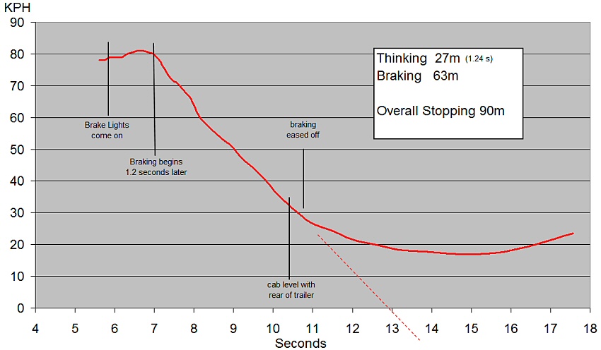

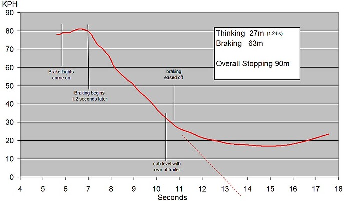

Here is a video that I have found of which I presume is a real life situation. It is a good quaulity video and as it is at a junction with good road markings I have been able to put some meaningful numbers onto it. If road markings are accurately painted onto the road and digital cameras precisely take 30 pictures a second then my figures could have some rough accuracies, It is a great pity I don’t know how heavy the camera lorry was or how many axles, it could be two axles at 18 ton or an empty artic with 6 axles running at 17 ton. disc or drum ?
The figures I have come up with are not as good as I had expected. From 50 mph, 27 metres thinking time then possibly another 63 metres stopping time (I know it didnt stop but that would have been hos stopping distance had he continued braking at the same rate see dotted projection line) And that rate of deceleration would only represent 0.4 g a good bit lower than suggested earlier in the thread and nearly half of my guess of 0.75g.
