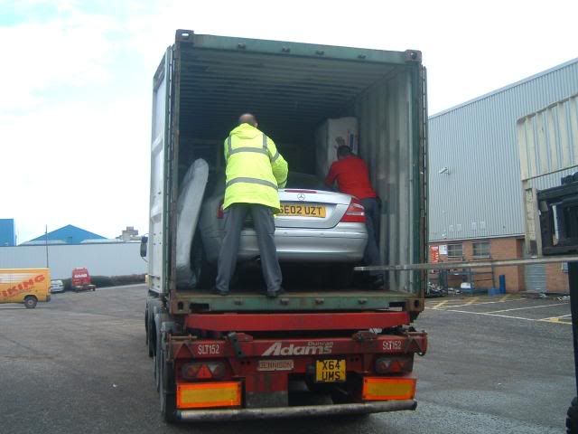

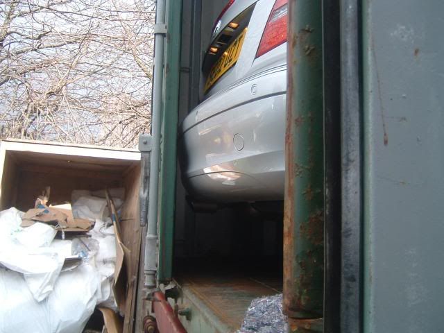

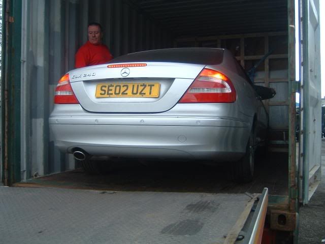

Took a 20ft box to a removal company in the southside of Glasgow once . and they filled it to point with furniture and then load this Merc in. If i can remind right they just strapped it down with two straps on Off side front the other Near side rear… and then put Mattress’s wedged in-between and other soft furnish’s on top…!! And not an ADR sign or Reg in sight…lol
man-tga:
I hope that bumper pops out when they open the doors! :open_mouth:

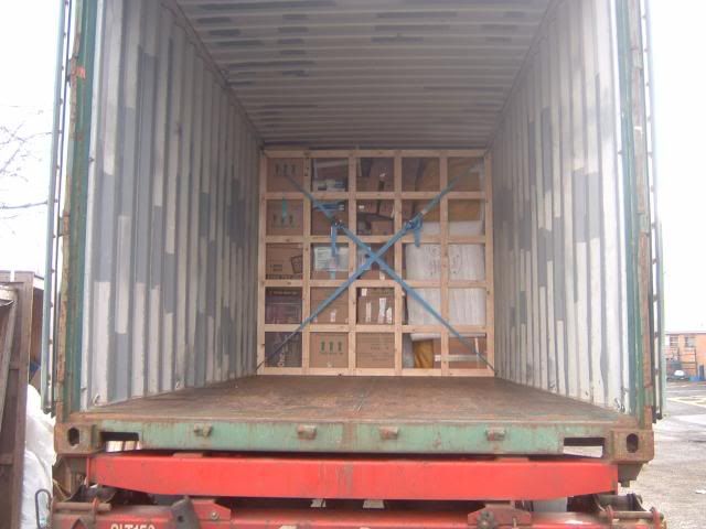

Ontime Automotive ship a dozen or so cars a day from Fenny Compton in containers. Aston Martin and the like. They secure them with wooden blocks and a nail gun and it is their responsibility to make sure they are secure.
When I shipped a used car to Africa I sent furniture in the same box, a bit like the one pictured above. I had to drain some excess fuel and take the car to the vets to have the wheels deloused. When I picked it up they just let me drive it out of the box and we had the container delivered separately.
