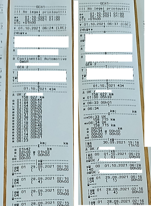

Hmm - I note the comments about making an incorrect manual entry, but how does this explain the fact that both the tacho head and the vehicle dash show 140+ hours of driving time? There is, as far as I am aware, no way to use the manual input facility to enter driving time - the only options are Rest, Work, POA or “?”.
Sent from my VOG-L09 using Tapatalk
^^^^ the vehicle dash display takes its cue from the tachograph and I’m willing to bet that what the op intended to say was 141 hours continuous duty time as opposed to driving time.
The display and tacho head are pictured near the top of the tread.
Check for yourself.
In this case it is 100% a tachograph/card fault. I had one very similar.
In OP’s photo
From the tachograph manual
https://www.fleet.vdo.co.uk/media/1813/ba_dtco_40_en_internet.pdf
Data set for events or faults
My printout
I happened to take a printout before I ejected my card, then noticed the error on the head so I reinserted to check and made the second printout. You can see everything after midnight (UTC) has been lost and recorded as other work. I have used the same vehicle and many others since and not had the same error.
Cuttlefish:
In OP’s photo
My printout
Well spotted and having the same issue obviously helped in spotting what was wrong here.
So either a tacho head fault and or a card fault.
I’d guess it couldn’t write to the card for some reason, but seems in both cases to be writing to the cards after.
Very strange scenario indeed.
Sent from my CPH2173 using Tapatalk
I said that on page 1 where I linked the manual.
The print-out is clear - it has recorded a card error and an internal fault. There is a problem with the tacho.
Maybe the night driver avoids the problem somehow in the way he operates it? No idea, but the print-out clearly shows a fault.
