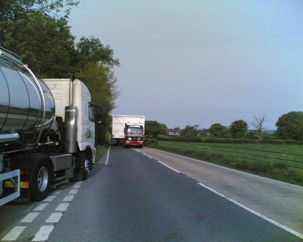

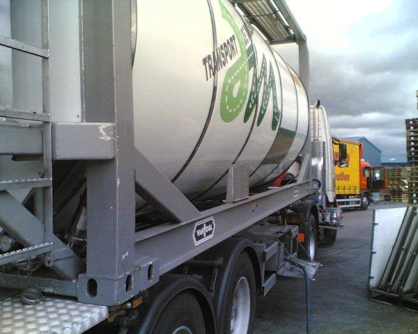

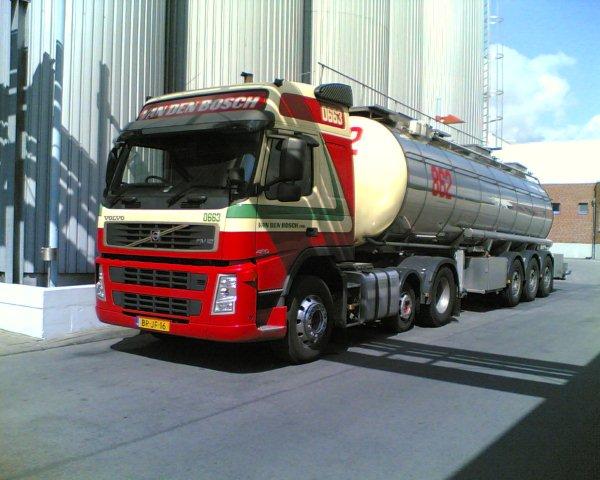

These are the 2 different types of exhaust stacks on my recent drives. In the food industry, they don’t want exhaust fumes in the factory with the chocolate.
The VDB has a rattling flap, the DMT has an angled pipe
