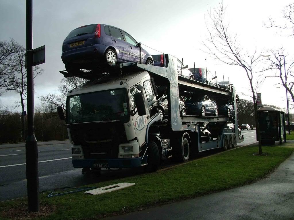

Here is a pic of me broken down in Newcastle today, luckily near our depot, burst hose fixed by our top fitter on the side of the road.
Can’t get cab that far up!!
The offending item.

It’s only a hose FGS, drop the trailer pull forward a couple of feet. Fully tilt the cab.
Job done.

Was being sarcastic with the top fitter bit. However, same happened in Scotland a couple of weeks ago and Volvo Truck and Bus wouldn’t look at it unless cab was fully over.
Can’t drop these trailers loaded unfortunately, and unloading 9 cars on the side of the road isn’t an option. What you can do if you have the space is to jacknife the unit so it is clear of the peak and it will go over, thats what we did in Perth.
