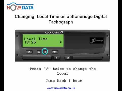

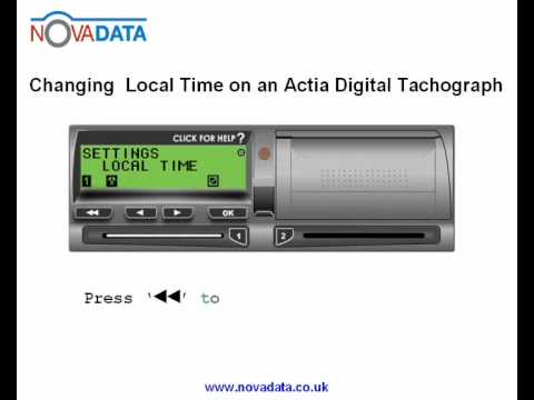

If it’s an analogue you’ll need to adjust the clock manually. If digital, all recordings are in UTC (universal time co-ordinates) but you can change the display to local time if you wish.
Hope this helps, Pete

Yep, no need to change anything unless you want the display time to show local time.
