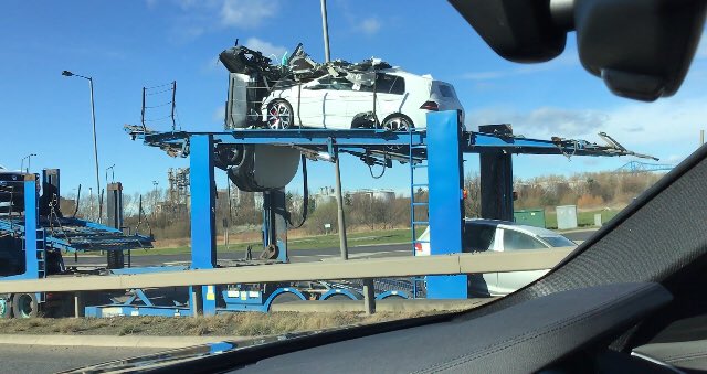

I passed this yesterday , dont know how he managed it as bridge was’nt marked as low bridge . Unless car was sitting wrong
gazettelive.co.uk/news/tees … s-15948345
Drag top deck not down maybe??
Ooof! If a job’s worth doing etc! I assume it’s the bridge at the entry/exit road into Teesport between the main roundabout and the Security Checkpoint
Even though it’s not signed as a low bridge, it looks as though it should be, maybe the brutal industrial architecture makes it look that way especially when I’m taking Tesco double deck trunks under it, going to and from the RDC
As previously suggested it looks like the deck on that car transporter hasn’t been set at the correct travelling height and the back end of what looks like a VW Golf has taken the full impact, must have been a hell of a bang! On impact

oooof! thats exactly what i said when i seen it.
this is on a66 the bridge he or she hit takes you in to the riverside stadium , i passed under the bridge your talking about going into the port it had me worried after seeing this and my trailer was just under 16ft .
Yup, top deck’s still at full height, probably around 17.5/18.5ft high the top of whatever was in position 1.
As a rough guide for max running height the top of the posts of the sideguard rails want to somewhere about the same height as the top of the pillars.
The first newspaper picture shows the top deck at least partially lowered doesn`t it?
The other picture with the top deck fully up MAY have been later when the lower deck was being off loaded?
I would say the deck was lowered for the recovery operation, but happy to be wrong here, with the deck at the lower height seen with the crane in shot the cars would have been below pillar height so under 13’ 3".
Thinking about this more, at full deck height he might have and most likely has pushed the deck with the damaged car (position 1) out to full length in which case it could have been around 20ft high.
Just shows how strong those decks and pillars are though that the transporter itself is still basically operational.

Yep, surprisingly strong kit.
To have been running with the top deck fully raised would have been VERY surprising* wouldn`t it?
Not just a case of a few inches out.
*EDIT, tempted to say “impossible”, but…

Multi drop on busy roads, hassled by office/customer/public/traffic warden/nagging partner/other personal issues, time ticking by for a deadline?, who knows why he forgot to bring the decks down but he did.
Its one of those jobs where you have to ignore everything else that’s going on around and concentrate purely on the job in hand, take your mind off it for a second and that’s the result.
Don’t forget the driver has complete control of all the decks on these, the combination of deck movements and angles to suit the load is almost infinite, takes most people a year or more before they are even remotely comfortable and at ease with the job, some pick it up in months, many more take several years, some never get it.

If he.s come out of Teesport though hes already gone under 3 bridges before getting to the one he hit
chaversdad:
My guess would be that he’s done a delivery somewhere around Cargo Fleet and not returned the deck height to its normal running position.
Don’t suppose it could be a fault in the hydraulics whereby it’s raised slowly since they left the site (or even a slightly sticky leaver that wasn’t 100% reset)? Would have thought they’d have an auto lockout mechanism when moving, but maybe not.
As for it being down in later pics, it looks like the car on the bottom deck was removed in those pics, so likely was just moved for recovery.
