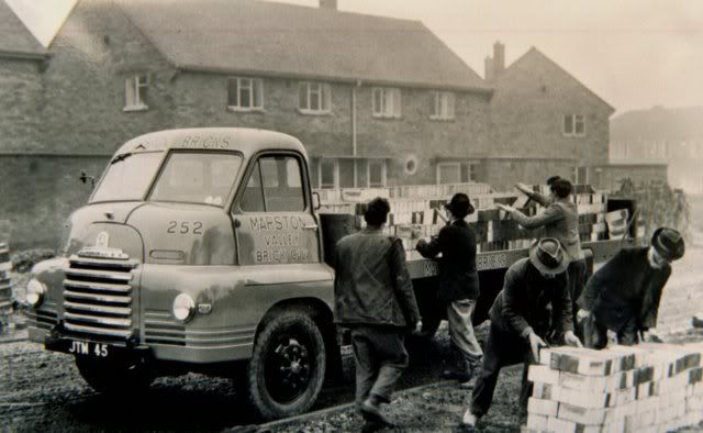

Just wondered how you used to unload bricks years ago - if it was handball, how was this done?
Basically, with your arms outstretched, you’d grip as many as possible and transfer them from the stack on the truck to a stack on the ground.
I used pads made from old truck-tyre inner-tubes to reduce damage to my hands.
There was also a clamp with which you could pick up about six at a time,but in my book it was one of the worst loads to deliver.Good job there’s a thing called progress!!
Regards,900X20.
That must have made your arms ache…how many bricks were on a 40’ trailor
I used to work in an unloading gang on a building site in the late 60s and unloaded hundreds of brick lorries by hand.
Not entirely sure what you mean about how it was done but we used to stand at the side of the truck and take the bricks off usually about six at a time i think and stack them neatly behind us.
Common house bricks weren’t much of a problem but we had to be more careful with facing bricks because the face could easily be damaged and the last thing a bricky wants is hundreds of chipped facing bricks to sort through.
They would be stacked in rows on their side and at the ends of the stack there would be alternate rows facing the other way to bind the ends of the stack, if my memory serves me correctly the artics would have 7,000 (could be completely wrong about that though) bricks on them and on a good day four of us could unload a truck of facing bricks in 30/40 minutes with minimal damage to the bricks.

Yes it was by Hand, I was on the unloading gang on Heron Estates back in around 1972/3. We’d unload lorry after lorry & it used to be great to be getting towards the end of the one you were on only to see two more pull in just up the road. It was non stop all shift but it kept me fit. We had a chap on the gang that cloud hold more bricks than any of us. To be honest, I can’t remember how many he’d pick up now, obviously ordinary house bricks would be very much lighter than engineering bricks & he’d make us look silly ig he was in the right mood.
We used to almost throw concrete blocks to each other to make the stack & thorouglhy enjoyed doing a load of Thermolite blocks or Marley Tiles because they were such a different beast compared to the bricks. They were good days, hard work but everyone seemed to get on & do the job. I think they carried 6.500 Bricks on a 6 wheeler 8,500 on an 8 & 11.000 on an artic but it was almost 40 years ago & my figures are possibly wrong. We also used to unload bags of cement which were a doddle compared to the hard items such as Bricks & Blocks because the bags were still often warm & plyable, although they then weighed 1cwt (about 50 kilos) they too were easy for a team used to working together.
Hydraulics now do everything, we started to see lorry based cable operated forklifts on London Brick lorries about 1973, if one of those turned up it was a breather for us, he’d go off & unload himself while we finished the handball work. Just about every building site has at least one forklift to do the work in a fraction of the time as well as doing most if not all of the loading out on site.

You ask how we unloaded bricks!!! usually we got 3 labourers …4 was a gift. you stood at the side of the load
and usually took 4 bricks and put a row alongside the lorry straight below the chockrail. these you could stand on
to make yourself taller. now you have a full length layer of bricks the lenth of the trailer and 4 bricks wide
as the layers get higher the more into the trailer you can reach. The bricks was 10 wide on the truck so after
youve got 4 bricks back from the chock rail.IF you was lucky you could turn round.(if it was a bad tip as you turned
round you rocked the trailer on the turntable and 2000 bricks would fall off one side) when you had turned the
stack would be just below the flat deck so you stood on the stack and filled the back row up to about 2ft 6 higher
than the trailer you did,nt have to bend at this time then you filled row 3 upto deck hight by now you could throw
the bricks at the back rows and fill in to the height of the back rows.we would lift bricks as many as 10 at a time.
we would say to the labourers have you seen this you,d have 6 bricks(the labourers had 4 )so they,d do 6 so you,d do 8
and they,d copy you(that speeded things up) If you worked well it took about 90 mins to do 10,000 bricks.3 labourers
To show off if you could see about 12 bricks you,d pick them up( that was a row of 12 bricks squeezed from each end)
they needed to be dry.(lighter)There was a chap who could do 18 bricks.(londons they was quite light)I hope you get the idea.
we never passed bricks to each other you picked them up and stacked them.
