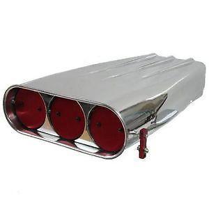

No I think he means one of these,they put air in the carb
