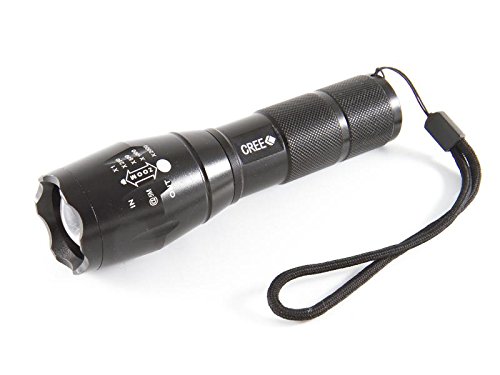

Thanks for the great posts here DD, you have answered my questions while I was looking for a checklist on Google
One thing I am stumped on here -
dieseldave:
An intrinsically safe torch is only required if the vehicle is carrying Classes 2.1 or 3 and the driver needs to enter the load compartment. [ADR S2(1)]
In all other circumstances, an ordinary torch is OK as long as it doesn’t have a metal surface liable to make sparks
[ADR 8.3.4]
- Does that mean that all torches can not have a metal surface? Even if you are only carrying classes 5’s, 8’s and 9’s?
I use one of these bad asses, super bright LED and the 18650 battery lasts ages in it - BUT it is all metal on the outside.
Also, I thought this only applies to the 2KG one

Hi SEDriver,
Your torch seems to be OK.
It doesn’t exactly prohibit metal torches mate, it just says this about torches:
ADR 8.3.4 The portable lighting apparatus used shall not exhibit any metal surface liable to produce sparks.
I’m thinking that your torch is possibly made of a soft alloy that might be non-sparking?
