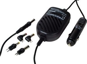

ive got one of these & it charges my 15" laptop with no problems, 19.99 from maplins.
