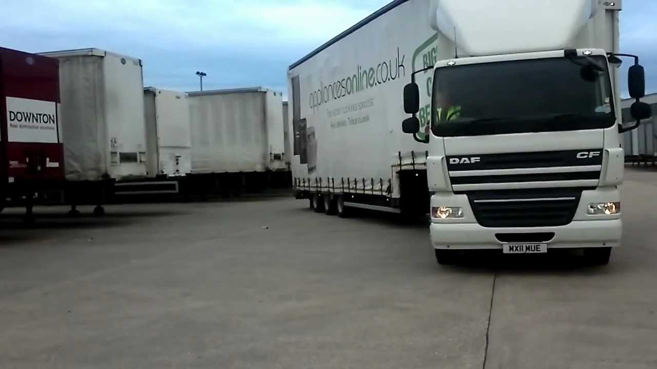

What no one here has mentioned yet is that the driving test reverse is a manoeuvre of a shape and direction that you will use ever again! It has no use in the real world and is only used to judge your ability to understand the principle of reversing a trailer by the DVSA, can you turn the trailer to the left, position the tractor, judge length and steering input, turn right, go in a straight line etc etc.
What you need to understand is how to complete a ‘screw turn’ something your trailer tyres / employer will not appreciate but essential to place a trailer between two other trailers with normally 3 ft each side within a fairly compact turning area.
You made the mistake of trying to go into the space a 45 degrees, you need to do it 90 degrees instead. Its soooooooooooo simple, drive backwards in a straight line within 5 metres (you don’t need a great space on your right - just enough to swing the unit) of the headboards of the trailers parked up towards to your space (a 15ft or so gap, between trailers), once the centre axle of your trailer is inline with edge of your gap or just before (hold your nerve!) apply FULL left lock, watch the trailer tyres - once the centre axle stops turning apply FULL right lock until straight with the trailer - at this point straighten the steer wheels and check before the trailer enters the 15ft space that it is clear both sides. If done correctly it makes you look like a real smarty pants. You can customised this, screw it less or more to suit different locations, depends how much space you have or what angle you begin the reverse at compared to the bay position.
IT A ONE HIT WONDER, NO 2ND CHANCE, if you turned to late or early its back to the start matey, AND ALSO DON’T DO IT BLIND SIDE, well not yet - you might need a bit more practice or a rear window to crack that one.
This method turns the trailer in front the space, what you were trying to do was reverse into bay at a long curve, which normally leads to striking the other trailer on your blind side - that’s how most of us learn the screw turn - out of a need in the real world to avoid accidents.
Have a look at this video https://www.youtube.com/watch?v=nLTDef0oeuA, its an extreme example because he holds the screw turn longer to obtain a 180 degree turn but once you understand the principle of both pivot points on your trailer - the king pin and the wheels you will be able to do anything the other more experienced drivers display (however not everything is professional).
Note: Loaded trailers on concrete - you will cause a great level of tyre wear, best used only on loose surfaces or if you really have no option, also its recommended to check your suzies don’t get caught up on curtain handles, keep them stowed behind the curtain. Many of us have learnt the hard way - snapping a hose on the turn - twang…hissss - bugger!
BTW - that’s why the truck had a steering wheel assister knob - helps you turn from full left to right while leaning out of the window to look at the centre trailer axle! Remember transport yards are dangerous places and don’t strike the cab side air deflectors on the trailer at full pivot and keep an eye on overswing when steering - looking/checking cab and trailer overhang/projections - mirrors, bumpers etc. As you drive forwards before reversing scan the area for obstructions and don’t wait to hit something - get out a check beforehand!
Here is few more - all bit different, some not quite accurate at all times because they are travelling too fast showing off for the camera but you get a few ideas from it.
