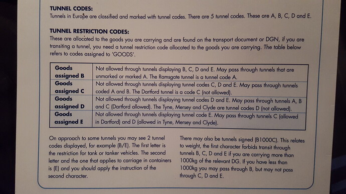

Just to clarify please.
I have a load on a curtainsider with tunnel code C/D. So my understanding is that as I am not in a tanker, tunnel code D applies, so I am ok to use dartford which is a C. If it was a tanker load then it wouldn’t be allowed through the tunnel as a C load can’t go through a C tunnel.
Does that sound right?

As general rule yes you are correct, but it depends of the bulk load.
transportsfriend.org/dangero … -codes.pdf
P.S. Check the bottom when you open the link as well.
Hi SEDriver,
Yes mate, you have this spot-on. :smiley:

Thanks for the answers.
I meant towards the industrial estate, not through it. :laughing:
I got sent in there when I was over height because the big tunnel was closed (a couple of years ago), I don’t believe they let you wait in the holding area any more.
The sign is very confusing;
It says “Prohibited Vehicles follow hollow diamond” but if I have a tunnel code D then I am not a prohibited vehicle :confused:
