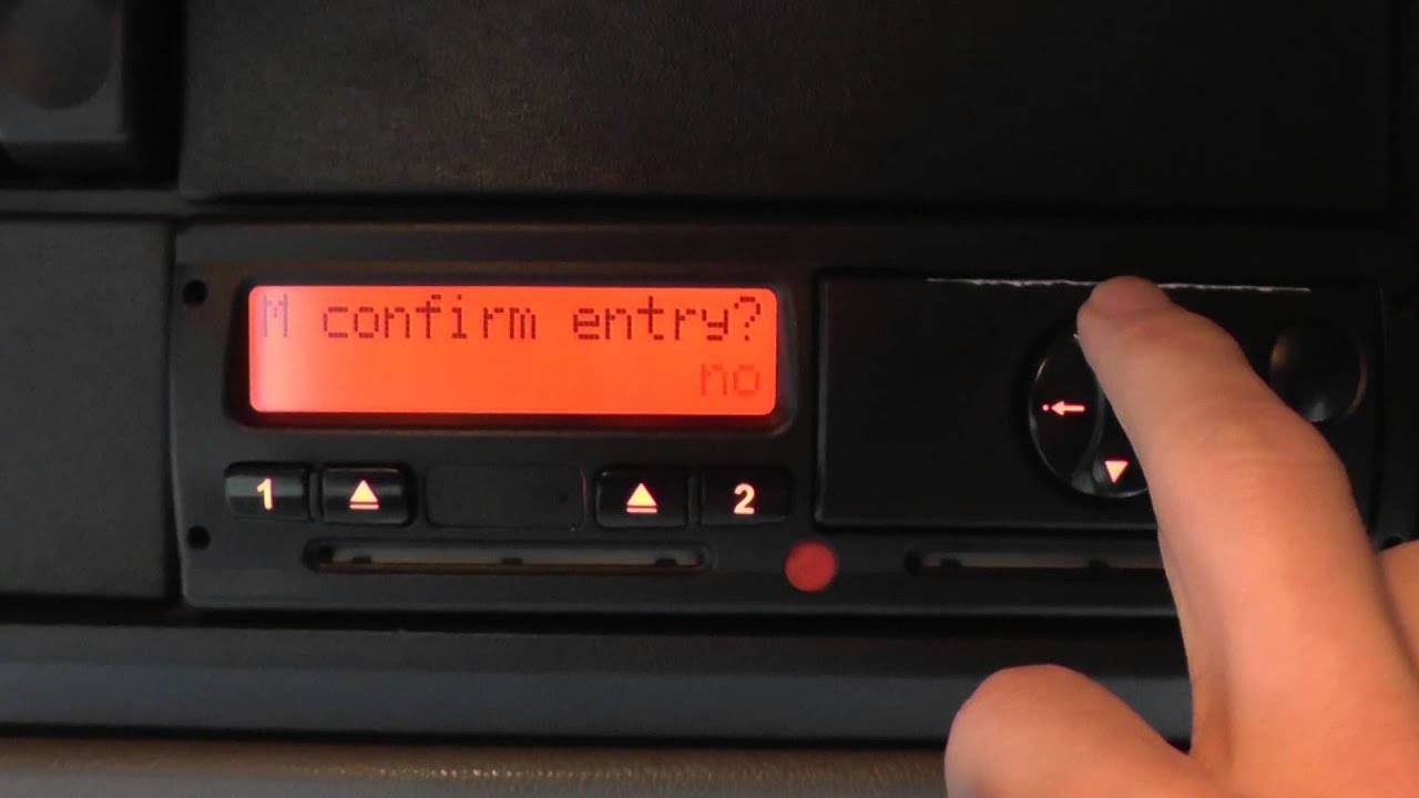

What make tachograph is it, Siemens or Stoneridge and how old is it ?
You can’t record any of the analog work on a digital tacho anyway because you can’t enter the reg or mileage of the analog vehicle
Here is picture m8 can’t find handbook to see model ill ask supervisor when back if don’t know…cheers
Never thought of that m8 cheers like I said am not used to analogue seems am not used to digital either at min lol
That’s a Siemens mate, for future reference
As said it is a Siemens tachograph but we still don’t know how old the vehicle is so don’t know if it’s a type 1 or 2 tachograph, from the image I’m guessing it’s a type 2 but I could be wrong.
Have a look at this video, if the display during manual entries doesn’t look like yours let us know.
It’s slightly different m8 it asks for the times and then after entering times it goes to choose mode I just tested it took my card out then did manual entry for the minute I took it out for…
The screen here has the time flashing…
Choose mode ![]()
How old is it ?
Perhaps it’s a type 1 then.
