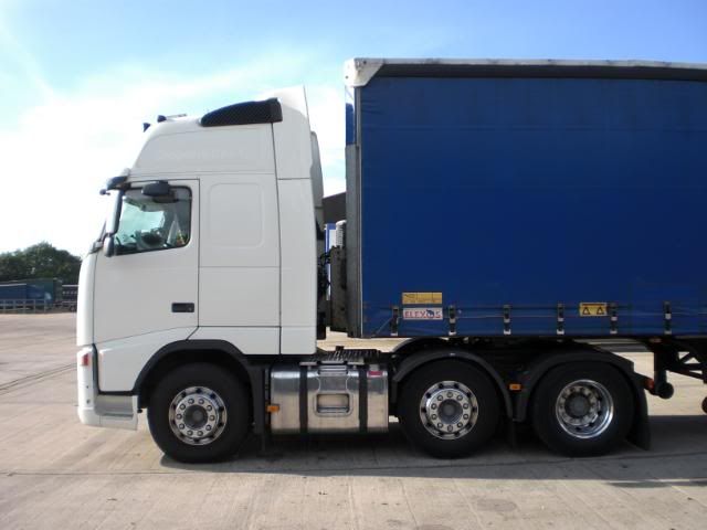

kindle530:
Nice shiny wheels and tank, let down just a little by the plain white ex-rental cab… :stuck_out_tongue:
ex Gwynedd Shipping motor H! plain cab with no writing= no-one knows who you are :wink: :smiley:

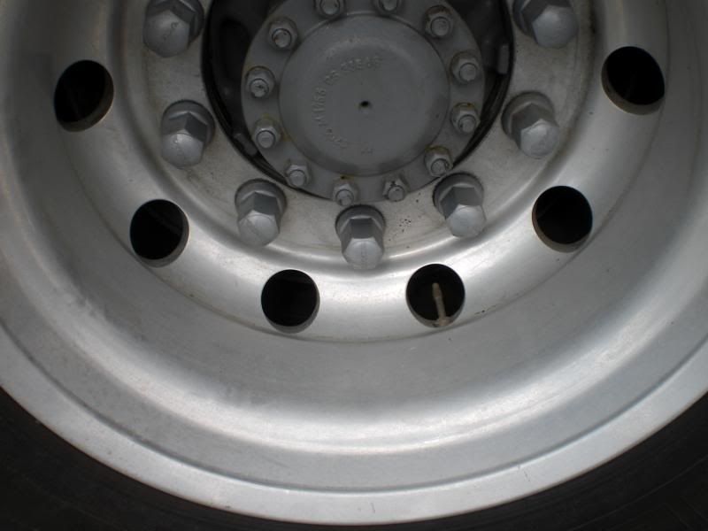

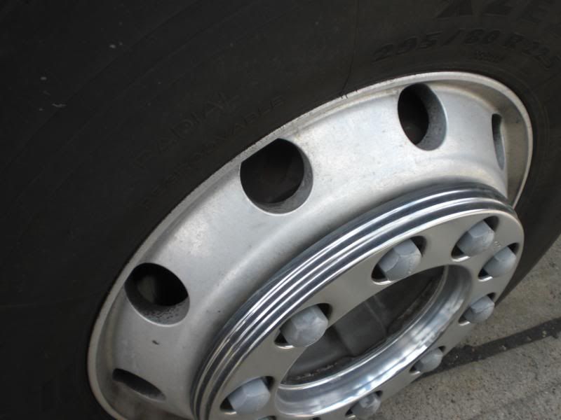

Here is one I did today
From this…

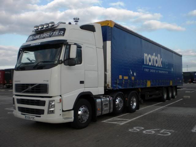

kindle530:
I knew who you were? :laughing:
