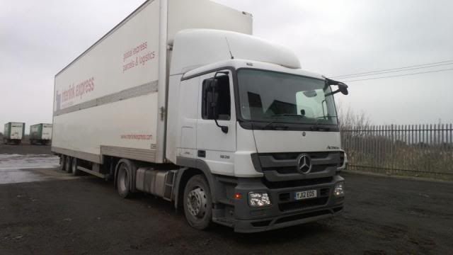

Have just got a full time job on artics. Im driving a double deck trailer
But every so often I feel it pulling me to the left and right.
I thought it could be loaded top heavy but after checking it wad ok
I only passed last july and enjoying it. But did crap my self when this happened
Driving a Mercedes actros. Up and down to north Hampton fortrec
Any advice bee good

i have spent all week with an actros 1836 pulling a decker. that movement is likely to be the road surface so dont worry about it. just gently correct it and keep your cool
I think this sounds like motorway tramlines too. Don’t try to correct for it by waggling the steering wheel just hold it firmly in the dead ahead position.
Been pulling a double decker with an Actros every night for the last 9 years. Still not an expert but sounds like tramlines to me.
