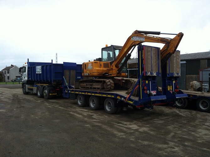

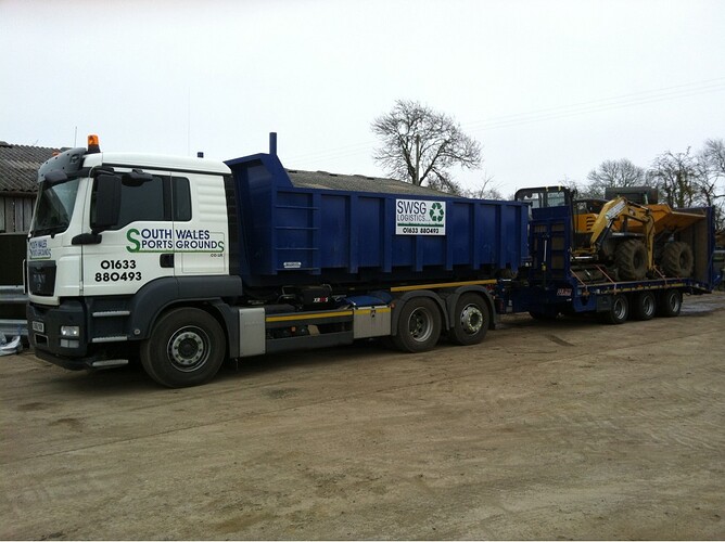

This is our other truck:
As you can see we put a fair bit of thought into our trucks, and they are used for lots of different tasks, thats just because of the work we do. But it’s not cheap! Myself and my dad helping designed the hook loader and drawbar combination and it took a lot of putting together with the ramp setup, it even has twist locks and can carry two 20ft containers. We would expect to get another 300 km out of that Scania, it will take us a several years though as most of our work is as you can guess… In south Wales.

That setup would suit me down to the ground if it had a Hiab. I could probably get away with a good few less horses too. What would you recommend in terms of power for say 14 tonne plus the trailer? Can’t make out exactly the model on yours.

Well that MAN TGS in the photo is a 440 euro 5 but sadly the add blue model due to a rear steer option on the truck, we went for plenty of horses as it can be running close to 44t and all round the south Wales valleys. I’m not 100% but it might be the biggest engine option for the TGS.
Our Scania is a 380 although we got it chipped to around 440 apparently… Although I think it outputs slightly less than that but still copes well and is usually running heavy too.
I think you want to be around the 300 range to be towing a drawbar and if it’s lacking a bit you have options to increase power.
We also built this custom short body that clips onto the Fith wheel of our Scania, I have seen a few people do it since with other hiab tractor units and even pull a drawbar trailer. We use ours for very small jobs and tight places, it’s very handy as we even made it with front twist locks and a rear pull out with lights and it can carry up to a 20ft container although I do ■■■■ myself with the overhang!
