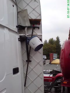

Here is a pic of acceptable intervention equipment on a tanker that carries Nitric Acid:
(Note the plastic shovel.)
Here’s a different tanker, but I can’t remember what this one carries. :frowning: :blush:
In this case, the shovel is metal.
I hope this general advice helps, but I’ll wait for your PM in case that changes things. :smiley:
