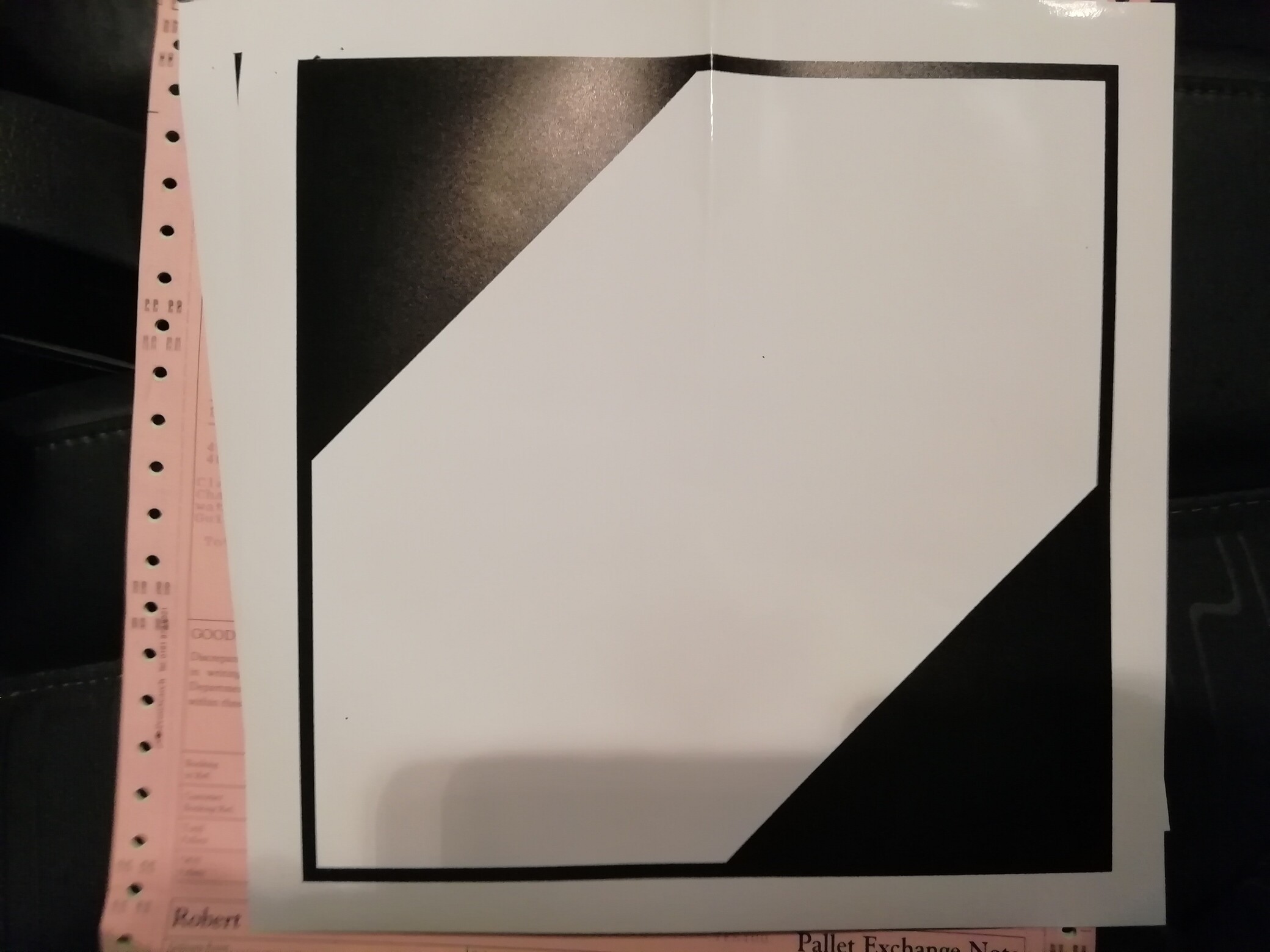

Hopefully the image will upload but I was given those with my paperwork. There is a note about hazardous goods on the paperwork
First should I display those stickers?
Second I don’t have an ADR card so should I be doing the delivery?
Thanks
Thanks
Yeah, one on the back doors, one on the dash or the headboard. Think you’re supposed to have them on the sides too, but nobody seems too fussed about them. No need for ADR with LQ.
Judging by the paperwork, they have been doing these loads for many years and know what they’re doing. I wouldn’t worry.

Thanks I hoped it should be ok but wanted to check
LQ (Limited Quantities), so you are perfectly fine to carry this load without an ADR.
It’s more to do with how they’re packaged, I do them regularly and I haven’t had an ADR for many years.

Hopefully the image will upload but I was given those with my paperwork. There is a note about hazardous goods on the paperworkFirst should I display those stickers?
Hi kcrussel25,
Yes, you should display those placards.
One on the front of the vehicle, the other one on the rear of the vehicle.
Hi Drempels,
The front one must be on the front of the vehicle
Drempels:
There’s no need to placard the sides of the vehicle if the entire journey is by road.
Placards are only required on the sides (for this job) only whilst the vehicle is being carried on a ferry.

No need for ADR with LQ.Judging by the paperwork, they have been doing these loads for many years and know what they’re doing. I wouldn’t worry.
Agreed. ![]()

Cheers dieseldave, kept seeing them on the sides of trailers that will never see a boat in their lives, and I thought maybe the safety freaks had made yet another “improvement”! ![]()
Drempels:
Hi Drempels,
In my experience, it’s based on a misunderstanding.
Placards are required on all four sides of an ISO container by road, rail and sea. We’re all on the same hymn-sheet on this, which saves the container brigade from arsing around swopping placards at points of interchange between modes of carriage.
Placards are required on all four sides of a ferry trailer exactly as above, because that can also travel by road (ADR) rail (RID) or sea (IMDG.)
Some people get themselves a bit mixed up at the point that they consider a normal trailer that’s solely on a road journey, which only requires to follow the rules in ADR for a vehicle/trailer travelling on a road journey, which are in this case… An LQ placard on the front of the tractor unit and another LQ placard on the rear of the trailer.
kcrussell25:
What is the “general awareness training”? I may have had it but am not sure as I am only agency so haven’t had the full induction. I don’t recall anything specific. Might need to mention it for future
Hi kcrussell25,
ADR says that the training should be appropriate to the responsibility and duties of the individual concerned, so it will vary according to the particular job.
As a rough guide, a driver should be familiar with the general requirements for the carriage of dangerous goods. When carriage involves a multimodal transport operation, the personnel should be aware of the general requirements concerning other transport modes.
In line with the degree of risk of injury or exposure arising from an incident involving the carriage of the dangerous goods that you’re going to carry, including loading and unloading if that’s what is expected of you, personnel should be trained in the hazards and dangers presented by dangerous goods. The training provided should aim to make you aware of the safe handling and emergency response procedures.
Given that we’re talking of LQs, the above can be tailored to fit the particular job, but it shouldn’t be anything too complicated.
The training should be periodically refreshed to take account of changes in regulations. Records of training received should be kept by be kept by the employer and made available to the employee (or enforcement agencies) upon request.
If you were to attend just day #1 of a normal ADR course, this would give you more that required above and be eligible for 7 hrs DCPC at the same time. This is perfectly allowable, and you wouldn’t need to sit any ADR exam. The 7hr DCPC certificate then kills two birds with one stone. ![]()

All good mate, thanks for clearing that up for me! ![]()
