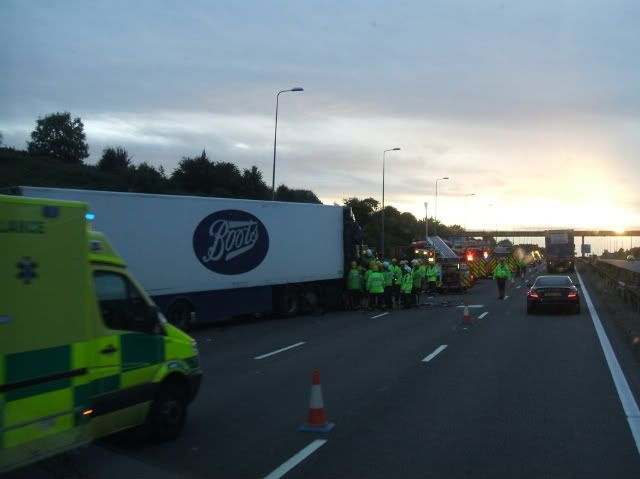

OK, i’ll say it :wink: - but you might not save your life :exclamation:
