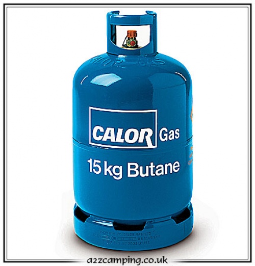

Are we talking about the small gas stoves like this?
or the bigger ones like this with a hob fitting?
I’ve always had one of the small ones without issue but I have heard countless stories of things going wrong with the big ones.
I wouldn’t want one of those big bottles in the cab,lol nor would i want it on the loose in the trailer ect, not unless i was away for months at a time anyway
The big ones used to be quite common in trucks years ago (perhaps they still are?) I know my dad had them for many years. I’ve always had the small ones and although they can sometimes leak when supposedly turned off, you always smell it straight away and re-adjust it or remove the little gas can.
