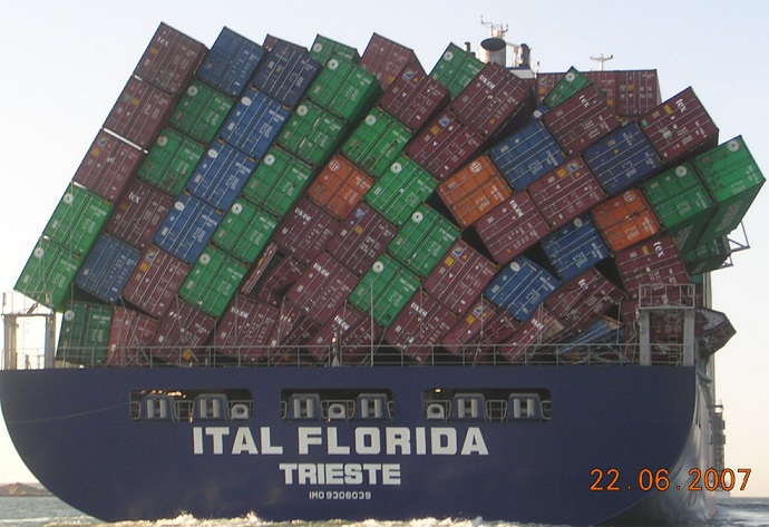

when its done right they look like this
but when it goes ■■■■ up :laughing:
WHOA hell,great pic…tis obvious he took the island too quick
Tower of Pisa, Ital Florida, Costa Concordia…
that lasts pics definately a… well boss, moment :smiley:
Nah, sharp right will sort that lot :laughing:
The Evergreen container hanging off the right-hand side of that ship shows how good the securing systems are when they work
