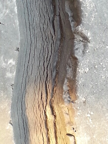

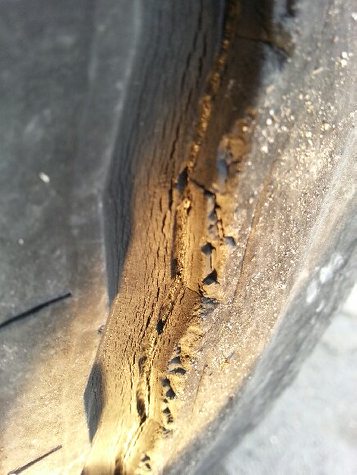

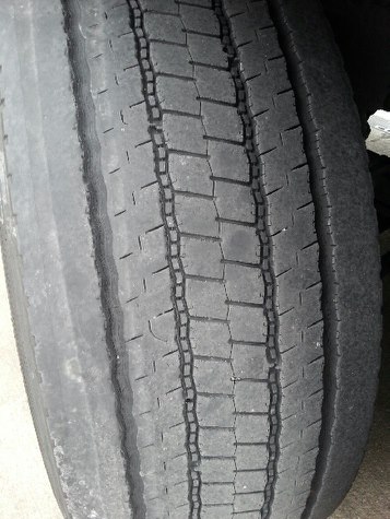

Ricki mentioned over cutting of tyres, what is your verdict on this one chaps?
It appears to have been a good ship spoilt by ha’porth of tar.
And if you were not convinced by those, what about these?
