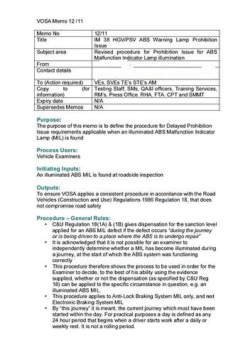

click on image to make it bigger
From the copy of examiner’s guidance posted by Ian, it is immediately clear how important it is to complete the walk around check sheet correctly. It is also clear that the muppet in the office is wrong to tell a driver that it is OK to take out a vehicle or trailer with an illuminated yellow ABS light, if it does not extinguish once the vehicle moves above a certain (slow) speed.
Print out this guidance notice and keep it to hand so that you have a copy to shove under the man’s nose when he tries to tell you anything different.
If the fault occurs during a journey then follow the instructions in the guidance.
If you were to try and blag it by claiming that a pre-existing fault occurred during the journey and be unfortunate enough to have an RTA which subsequently involves the vehicle being inspected, it is quite possible that interrogation of the vehicle’s ECU could catch you out.
