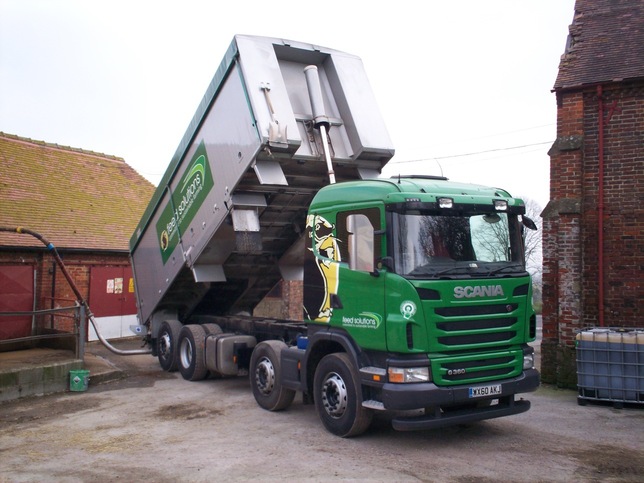

I was wondering if any of you guys running an 8x2 rear lift/steer could shed some light for me. Ive only ever ran double drive chassis for bulk animal feed delivery, but Im considering an 8x2 rear steer to replace our old 6x4 but we have quite a few tight farms to access;
What is the manouverability of an 8x2 like compared to a 6x4?
Do the rear wheels drop automatically when loaded?

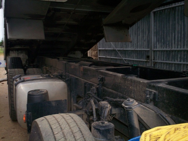

My 8x4 Scanias 2 rear axles share the same springs, what is the rear suspension arrangement for an 8x2 rear lift/steer? I assume the rear axle is on air but what about the drive axle?
Assuming the max gross is still 32T for an 8x2?
What about snowy/icy conditions with one drive axle?
Cheers

I’ve got an 8x2 non steering lift axle on an R420.
Both rear axles are on air and the tag will always lower itself well before the drive axle gets anywhere near it’s 11.5t max. There is a display on the dash which displays the axle weights for air suspended axles.
I do plant so a fair amount of off road driving, even with the Opticruise gearbox I’ve not managed to get it stuck yet, I was in a quarry yesterday and it was interesting but achievable. When you are loaded lightish but with enough to drop the tag axle then you may have some traction issues, you then have the difflock and another switch which allows you to transfer some of the loading from the tag to the drive. It will allow you to overload the drive axle too, I got mine to about 13.5t on the drive axle. Once you are on firm ground press the switch the other way and it will return to normal.
When we looked into a new chassis I thought we may as well enquire about a rear steer 8x2, the dealer reckoned they’d never done and it would cost an extra £8k for it to be steered.
Mine runs on super singles and the axle weights are as follows
  1. 8500
  2. 8500
  3. 11500
  4. 8500
That totals 360000kg although the GVW is 32t it gives flexibility and reduces the chances of overloading the front axles. (I also have a HIAB)
I think that you’d find a twin steer is always going to be a little less agile than a 6x4 but with my tag axle raised it is probably better than my previous 6x2 was with the axle lowered.

Weve had 8x2 lift-axles in the past (Volvo FM12) but not steering rears; axle will usually come up with the back box empty for shunting on farms. Wheels do drop when loaded, but you need to switch them down unless you’ve got less than 9 tonnes on, otherwise it can screw the lift pump.
Drive axle is still on springs.
Yes you still run at 32 tonnes GVW.
Personally I find little difference between 8x4 and 8x2 on ice or snow; only bonus with 8x4 is you can drop your cross-locks in, tip the cake backwards and have traction on the rear axle of course. On the other hand, with an 8x2 you’ve got so much more manouverability once you’ve emptied the back box and can raise the axle.

well what 8 wheels and G G have said is very true and well described i have drove 2 sister scanias 8wheelers 6x2 rear stears for the last year and you can put them in places you struggled with with a 4 wheeler !! The fact of grip is true but with the T C and the diff and the weight distribution switch i have never got stuck in and out of farms unlike my daf 6 x2 bag lorry i drive now and have had to have a tow on more than one ocassion , one thing one of are guys got warned by vostapo at newport that be couldnt have 5 ton in back compartment (over weight but not enough to be done ) advised 4.5 ton on back comp !!
agree with all above , the axle will drop at a preset loading , but you can dump the air from the back axle if TC & diff isnt enough , most of the MVF 8wheeler fleet is going the 8x2 route & drivers who’ve had concerns about going from double drive > rear stearlift don’t seem to complain as much as you’d expect them to, & there’s a great deal to be saved on tyre scrub when yer shunting around in 6 wheeler drops to get to the bins !
