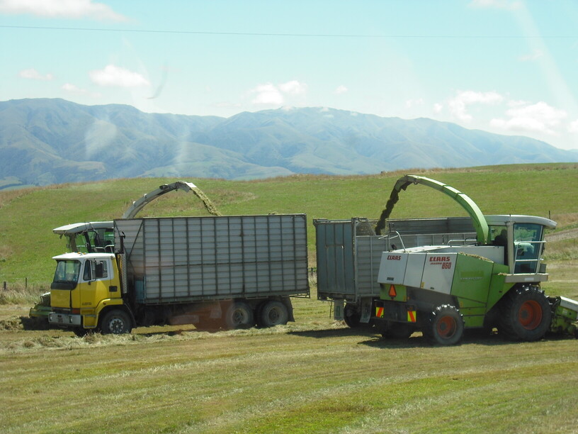

V6 OM441LA motor, apparently these run crank bearings. Having just bought 3 I would like to prevent this happening, have any owners any experience with these motors?. They are replacing 4 Leyland Constructors which are bloody good trucks.

I’m a silage contractor in NZ, use trucks approx 3 months then often parked up. There’s a lot of trucks here still earning 10/20 yrs old especially provincial areas, modern on road trucks can’t be repaired back of nowhere easily. As I said Constructors were very good off road, getting parts was becoming harder hence upgrading. As to Merc b/e bearing problem it’s in a few inquires on the net. Geoff
