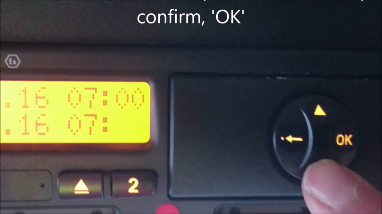

Ok so if a written manual entry is no good could somebody maybe talk me through it on a vu.
For example I put my card in and press yes on manual entry it will bring up the last time I drove this could be days/weeks ago. I would put in when the previous shift finished. Then press it to today’s date and manual enter the time I started my office work that day so example 9am and put it as other work.
Then do I need to put a finish time in for the other work for example 1pm and then start driving?
It then brings working time breaks into play etc doesn’t it.
Think I need to go on a course!! I thought when people said above about written records it would be easy
Best video I’ve seen on manual entries is this one mate. Tidy up the finish of your last driving shift as well as the start of your new driving shift and everything/ day in between when not driving but working, use a diary.
Great - thanks for that really appreciated it I’ll have a watch and hopefully get my head around it
Thanks again
Ok so Ive watched that video and I understand what I need to do however on the video it shows his last withdrawal and then he manually adds when he finished that shift.
Then he adds his daily rest to 7am what would I do here if my last withdrawal was weeks apart?
can I just manually input when I started my other work (office) without having to explain the time between my last withdrawal?
Ive just watched another video and it says to manual input the time u finished the shift after u last put card in then use the ? For the time between last withdrawal and start of new shift if there is a long time between drives. This true?
Where he put in the daily rest with the bed symbol, you would put the entire time from the end of the last driving shift to the start of the current driving shift with the ? symbol.
You cannot use the bed symbol because you haven’t been on rest all the time, the ? symbol symbolises time that cannot be accounted for, such as time that covers several days when you’ve been working and resting but not in-scope of EU regulations so not using a tachograph.
You need to know what make and type of tachograph you’ll be using, there are basically only 2 makes of tachograph you’re likely to have VDO and Stoneridge, they work a bit different so it would be helpful to know what make you will use, the type (there are types 1 or 2) will nearly always depend on the age of the vehicle.
Yes it is true
The ? is time that cannot be accounted for, for instance time over several days when you’ve been working but not as a HGV driver, or if you’ve been using an analogue tachograph for a day or so you’d record the time on a digital tachograph as unaccounted time with the ? symbol.
The ? is basically any activity that you cannot or should not or need not record with one of the symbols in the digital tachograph, i.e. unaccounted for time.
